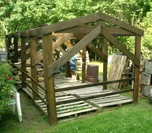

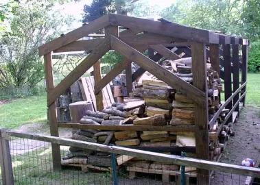

Well seeing how everyone is posting pics of their wood shed I thought I would post a pic of mine. The floor is pallets as you can see. The frame is made from 1x6 strapping; I was able to get the wood for free from a company that was giving away surplus skids.
I haven’t decided what to do for the roof yet. The simplest thing would be to just throw a tarp over the top. I was considering using clear PVC corrugated panels like these:
http://palramamericas.com
palruf corrugated PVC panels, they have them at Home Depot.
I would think the clear would let the sunlight in but keep the rain and snow out. Any one have any experience with this material?

It's gonna be a beauty. Keep the rain & snow out, fer sure. As far as roofing goes, I'm not sure that trying to build it with transparent or translucent roofing, like a greenhouse, is the goal with a woodshed. A woodshed needs good ventilation, above all else, I think. A dark, solid roof will absorb a whole lot of heat, and the ventilation will carry the moisture away to outside the shed. That's my theory, anyway. Lookin' good, keep us posted! Rick

looks good, how much wood you figure it will hold?? have you taken the inside measurements yet

Looks good. I was thinking of using those clear panels for my future wood shed addition off the side of my garage. While good ventilation is a must, some good baking by the sun doesn't hurt either.

Wess999, that will be a nice woodshed for sure. Don't know about a clear roof on one. Mostly when I get wood after work in the winter it is already dark so the clear roof letting in light wouldn't work for me. I used a metal roof and it has been there 30 years with no leaks and just a little rust showing now. Whatever you decide will work ok for you as long as it sheds snow and water.

Looking good! Looking good! put my wood shed up a few months ago and I put ply wood and that rolled roofing on mine. Looks good, worked well and was very fast and easy. And it was a lil cheaper than the stuff your talking about. At least the prices I got from big box mart anyway.
