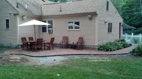

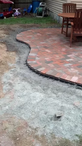

Well, after thinking about it for 4 years and planning it since last fall the patio is finally, almost, done!
I cant take credit for the work, we had a professional crew do this one. Watching them move in almost 14 yards of gravel and crushed stone, I'm glad I didn't try!
The surface is antiqued brick. We picked this location tucked in behind the kitchen to use some wasted space in the yard and take advantage of full evening shade from the house. The space was a bit limited because of the septic tanks location , which is also the reason for the curving shape (avoiding the manholes).
The major work is almost done, all the guys need to finish is grading the lawn around the edge tomorrow. Then we have a few weekends of DIY work landscaping the border. Plan is to put in mulch planter beds with brick edging all around, with a couple stepping stone paths to the lawn, and of course a Scotty O (tm) Keyhole firepit!
The landscaper has a load of salvage brick demoed from another job and he is giving me as much as I want free (!) which will be used for the edging, etc.
Also the previous owner had wired the house for outdoor speakers in this exact spot, so I got some cheap ones to install. Party anybody? :)

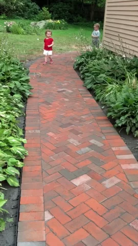

Our Quality Control crew inspecting the walkway:

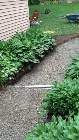

Having the walk between the garage and house dug up meant they exposed the old 30 amp electric feed. We had a gas stove put in last year so I had an unused 6/3 line available terminating just inside the wall here . I had the guys put in two PVC conduits for me. They are too shallow for code technically but we hit a big granite shelf a foot down. Hopefully the foot of gravel and brick on top will protect it ;)
One 1" that I ran #6 THWN through to tie into the 6/3 line and upgrade the garage panel to 60 amps. (First time I had to splice big wires like this, split bolts and rubber tape, etc)
A second 2" pipe left capped off for future use. Considering running phone out there, and maybe someday a 240v compressor in the garage with an air line running back to the basement shop.

Looks good!
Schweeet!
Nice upgrade to the yard.
You'll get many many hours of good, fun use out of it.

looks very nice. make sure you do not mix low voltage high voltage wire in the conduit, it is a no no
Reactions: ScotO
Yup, the 2 inch pipe will be for everything non-HV. Im thinking of running a couple strings of CAT5 through it for phone and a remote wifi hub, and eventually an air line - might use the rapidair nylon stuff.
The one inch pipe has the electric feed, three #6 THWN and one #10 ground. I tied this in to the pre-existing 4 slot sub panel that had a 30 amp feed. One issue I need to resolve is the grounding, it is tied back to the main panel ground and the neutral is isolated properly, however the electrician who installed it didn't put in a ground rod, which I believe is required for a sub in a detached building. I should add that.

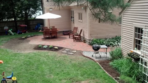

Well, except for reseeding the lawn, we are done!.
I once had a bare area next to my driveway. I didn't think the grass would every grow well there due to the high foot traffic and that area was often wet. So I put down some very small stone. Easy to walk on and it got rid of the mud issue. To my surprise, in a couple years, the grass grew up through the rocks and made a nice thick covering. Best part about this is that it never wears bear, and their is no muddy mess during any season
