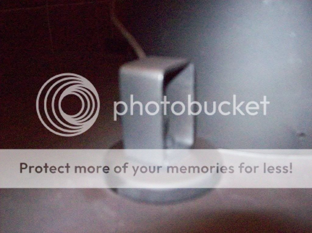

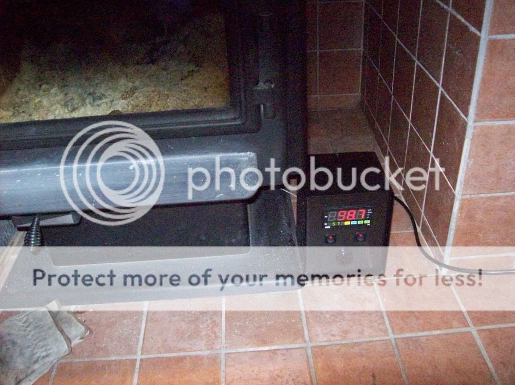

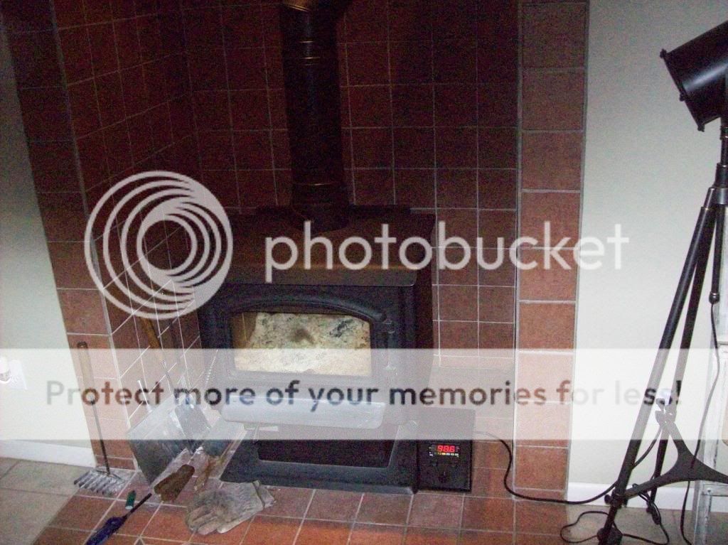

Here's some pics, maybe.
[Hearth.com] PID thermometer
Darn new computer. Hope you all can at least open these. My next challenge maybe to control the draft with PID. I'd like to figure out how to modulate draft instead of just open and close it.
The blaze king already has that.
What stove is that? Looks like an enerzone....?
It's a Lexington Forge which is now Vermont Castings. It' on it's third year. Needs a good dusting.
