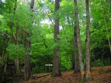

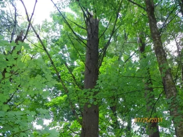

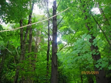

If the weather is good then tomorrow this topped off pine is coming down so we can mill it.
zap
  • Pine to be Dropped for Milling

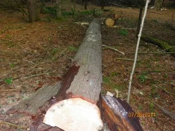

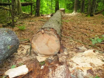

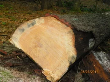

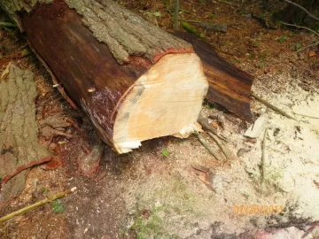

The pine is down, at the stump end it measured just over 24 inches across, the top measured just over 18 inches across.
The tree measured just over 23 feet, lost some off the top. What would you mill for length.
zap
Heck, it's like cutting hair, Zap. If you cut off too much you may regret it, but if you just take a little off, you can always take more later.
Mill the whole length, dude. Can't make the boards longer, mang... Can always cut them later.

If your needing 10-12 footer's for the shead nows the time....If not cut it in half.

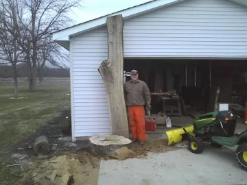

Zap that pine looks nice and straight. Do you like those rails? I have been just using an old wooden ladder for now, it seems to work fine but it is also only about 10 feet.
Yes, the ez rails I think are worth the money . I'm thinking about ordering another five foot section to the nine footer we have.
zap
Took a look at there site heck you don't even need shims lol....That is an easy set-up. Guess I learned the hard way. ;-) That is an expensive frist cut though.

Mine sells for table and bar tops so that makes it worth more...
