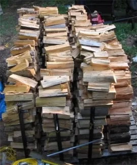

Pine is evil. All pine should be sent pre-paid to the Fed-Ex truck freight terminal in Manassas, Virginia c/o BrotherBart for proper disposal along with this pile which is scheduled for safe, scientific incineration this year in approved devices.
