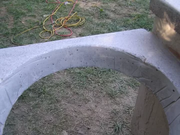

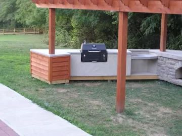

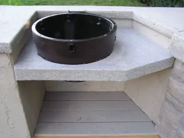

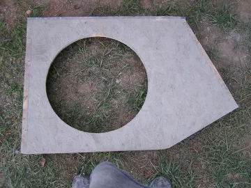

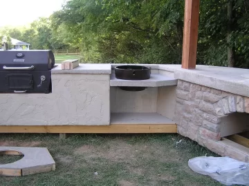

I installed the cedar siding and stained it this week. when finished it did not match the terra cotta stucco so we changed the stucco to a buff color. then we formed up the floating shelf and poured that, pulled the forms and started polishing it. I used the egg shell for the inside form, I wrapped it in plastic and poured around it. when it dried I popped the egg out. A little more polishing and I can start on the oven.
