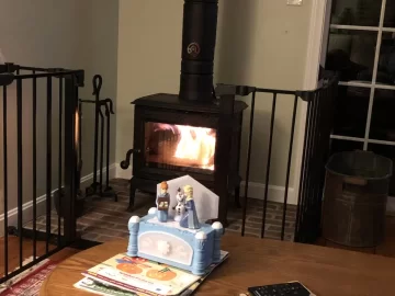

Hey guys-
Chiming back in here. I put the stove thermometer back on the top :-) Also picked up a probe thermometer for the pipe; I was a little hesitant about drilling a hole thru my new double wall, but got over that pretty quickly. We've had the F100 up to about 500 and for our house, so far, it does a great job. We have a center stair cape (~1,300 sq. feet) and the stove seems to keep the living room nice and cozy with enough hot air going up the stairs to warm the bedrooms. Granted it's not -10 out just yet, but we're happy with it so far.
I've attached a picture of our setup (pay no attention to my daughter's Frozen toys in the foreground).

Really nice! I almost went with an F100. Love the look if it. I decided on the F3CB pretty much just because it can take slightly larger logs.
The one thing I wasn’t happy with though is the fact that of all the stoves Jotul makes, the F3CB requires the biggest clearances. Smaller stoves and bigger stoves can be put closer to the wall. In the end...all good...I made it work.
Enjoy!
Looks good sesro 1978.
