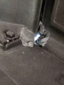

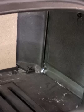

I recently had a Jotul Oslo 500 installed. After the installation, I noticed a small hole in the corner where the right plate meets the main body. It looks like some furnace cement is used to fill in the gaps and may have fell off during shipping (the stove does weigh 450 lbs). The installer said he would fix it the next time he stops by to install a heat shield.
My question is, is this normal? Should I be concerned and is furnace cement what was used to seal the plates? I've attached pictures to show the size of the gap. We still have a couple of months before things start to get cool, but just want to make sure I'm not missing anything.

Looks busted. Then again I have no clue about cast stoves.
I do not believe that is normal . . . whatsoever. Honestly, that looks like quite a gap . . . with or without cement.
Is that light shining through the gap?
It strikes me as a pretty big gap. The stove pieces should fit together and then the cement should just fill the joints.
I'd be inclined to go look at another new Oslo to see how that looks so you can compare. If you do that I'd also look at it from the outside. Just seems like that corner should come together better.
If this is a new stove, I would think that it’s a no brainer issue to request the dealer who supplied stove to replace the unit.
My guess is the installer does not want to install a replacement unit at his cost, which he should do, given that he installed a defective unit for you. Again, request that this stove be replaced and installed at no more cost to you.
Multi piece metal box full of fire on living room floor with poor loose fitting joints. Yes be very concerned
I'll send a pic to the owner, who owns the business and see what he says. I do have doubts on the size of the hole, versus filling in a small seam.

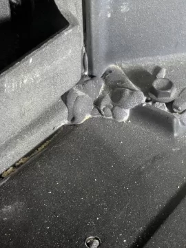

For contrast, here's the left lower back side. It looks like Jotul factory stuffed the corners/seams with furnace cement. I did see a couple of broken pieces in the driveway after they moved it in, so I'm thinking the right side lost a filling from the corner.

While “seeing what he says” is the first step, essentially I’d be demanding a new stove or refund of your money. If your dealer gives you any issue, call Jotul North America to report you problem with pictures.
Full disclaimer- I’m not a pro, but I Be suspect of both sides that you’ve given pictures of. Jotul is a high quality company and the seams you have there look like sloppy work. I have to imagine that that is not Jotul work. To be honest, if it were me, I’d call Jotul directly this morning and talk to them about this. They might direct you right back to the dealer, but they might want to look at those pics. Either way, you have issues with the stove that should be taken care of by the dealer and/or Jotul.

The casting all bolt together tightly, the cement ensures that it’s an airtight seal. This stove is not assembled correctly, do not settle for anything other than a replacement.

I do have to wonder, given the amount of cement that's on the left side. It looks like a tight seal on the vertical seams, but a bit more of a gap in the lower corners, hence the cement you see on the left side.

I also reached out to Rutland who produces furnace cement and saw the images. They said no problem in filling in, so long as it's layered and you wait hour hour between layer applications. Once cured, it hardens like brick they said.

I have to admit I’m not familiar with their latest models, but Jotul joints are typically of “tongue and groove” construction. The tongue on the edge of one metal plate fits into a groove on the face of the adjacent plate, and a small amount of cement is applied to the groove prior to assembly.
This means that, even in the event of a cement failure, you would still not see light thru a large gap, like that. Also, even when the cement fails, it usually stays captive in the groove, it can be quite a bit of work to get it out.
So, assuming these underlying features haven’t suddenly changed in their designs, that stove was not manufactured correctly. You should demand a replacement, and your dealer should demand Jotul take this stove back and take a look at it. I would never trust firing that stove in my house, as another cement failure like that (which is inevitable, given time) will turn it into a glowing forge, or worse.
