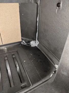

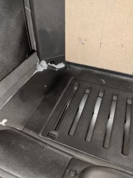

Plate seams on Jotul....should I be concerned?
That is definitely not right. Like all have said, you would not see a light through that big of a hole. Jotul in my experience is a very pro customer support Mfr, although it takes time and the dealer pulling with you. I think once the right people see those pix, a new stove will be gotten. Good luck, please give them a chance to make it right for you, they've been here a long time, they aren't going anywhere.
More confirmation here that this stove is defective, broken or not assembled correctly.
I completely rebuilt an Oslo and as others have said it is T&G construction with no such gaps possible even without stove cement.
If you fill that gap with cement it will eventually crack and fall out, that's not an acceptable fix. Good luck getting the stove replaced.

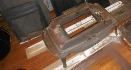

Hey Toploader - That should be super helpful to the OP! I've never seen one without the stove cement, but you have!
Here is a picture of the base you can see the grove that the sides drop into:

Sure doesn't look that way to me from those pictures. I'd try to get my money back.
Yeah, you gotta wonder what happened, here. I'd be willing to bet someone at Jotul will want to have a look at this one, it's not characteristic of the brand

The casting all bolt together tightly, the cement ensures that it’s an airtight seal. This stove is not assembled correctly, do not settle for anything other than a replacement.
Good news! The dealer's office called me to today to inform me they are replacing the unit. Apparently they were contacted by Jotul and asked to replace the unit. I did email the dealer couple of photos, but they originally suggested the furnace cement route. I then called and left voice messages with Jotul's tech support folks asking to at least weigh in with their opinion. They never called me back, but they must have contacted the dealer's office. I'm not sure if my photos were shared, but nonetheless a replacement unit is coming. Thanks to everyone and their insight on the question I had. I look forward to the re-install and using the unit later this season.

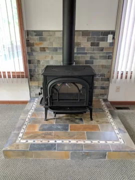

So here is the new, re-installed unit. It looks as if Jotul packs in the seams and corners well. Pic of right and left panels of the new re-install. Last pic is of completed install. Looking forward to seasoning it this fall and good use this winter. Thanks again to everyone who chimed in their advice and insight....much appreciated!

Much better. That's a good looking hearth. A couple tips: if you are going to use the side door, place a small non-combustible pad on the floor on the left side of the hearth. There should be at least 16" of ember protection there. And regardless of temptation, don't open the ashpan door to start the fire. Good kindling or SuperCedars will make this completely unnecessary if the wood is dry.

What is the distance between the stove and the blinds?
I believe the installer said a minimum of 9 inches. I think it's around 14 or 16 or more. The blinds roll out which I plan to do when I have it going full blast.
Please treat any stove on any setting as if it could go full blast, when you’re not looking. Things fail, occasionally. The clearances are designed to account for this.
