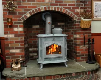

    Perhaps not in the price range you have quoted but the Woodstock Fireview or Keystone would really suit what you have quoted that you want. As for cat vs. non-cat, in the end they will both end up costing the same. As for upkeep, it is child's play as it takes me less than 5 minutes per winter to clean the catalyst. The benefits we received from this stove are that it uses only half the wood we used to burn and keeps us warmer. It burns cleaner. Whereas we used to clean our chimney 4-6 times per winter we have cleaned our chimney one time since getting the Fireview 5 years ago. As for looks, you can get the stove in many color combinations. It will cost more than the Englander but in our book, you can't get a more beautiful stove. During the non-heating season it just looks like a fine piece of furniture.

    Sprinter, those stoves pictured above are not enameled; they are soapstone. Look them up at www.woodstove.com
