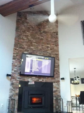

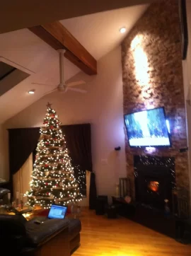

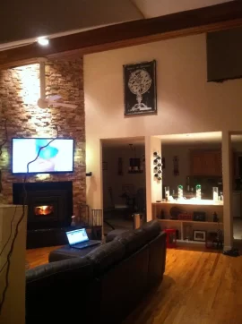

Im looking for some advice.....Two seasons ago I installed a Regency CI1200 wood instert (no blower) in my heatlialtor pre fab fireplace. Since I had a prefab , I was told my options were very limited as to what I could safely put in the fireplace..2200 bucks later it got installed. It looks great however it cannot pull my living room and kitchen area hotter then around 62 degrees on an average winter day. My fireplace would warm up this entire area and even my bedroom upstairs to about 75 degrees with only running it for about 7 hours. It says in the specs that the insert should heat about 1200 sq. The living room and kitchen are about 900 or so however there is cathederal ceilings in the living room . Ive read a few posts about back off plates and insulation....Is this something I should look into more?Im ready to bang my head against a wall lol...the salesmen told me that this would heat my house the same as the fireplace would only more safely and efficently.

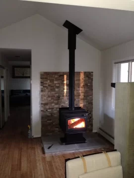

My house is quite large , about 4000 sq of living space all together however all Im trying to heat with the insert like i said is about 900-1000 sq feet . Since the insert wasnt doing the job , I even put a wood stove up in my bedroom ( 900SQft) . The bedroom door leads out to the cathedral ceilings where the insert is. I can make the upstairs just about as hot as I want . I purchased two 14" high velocity fans to blow heat out of the bedroom and use a fan in reverse to try and pull heat down . Is there a better way to pull heat down?? If any way at all to defy the laws of physcics to get that heat downstairs. Please feel free to chime in and ask any questions...Im looking for any advice possible . Its quite frustrating to invest in the insert and feel no return on my money . It honestly feels as if there is always a window open in my house and its just not warming up .

Looks like the problem is the high ceiling. Yeah maybe it's only 900 sq.ft. but how many cubic ft. is it?? You've got the right idea, having the ceiling fan blow up. Have you closed all the doors upstairs when you are trying to heat the lower level?
Wood stove in the sleeping quarters is unsafe, and a violation of code! !!!
Yes Ive tried both , leaving upstairs door closed and open. Im thinking maybe the wood Im trying to burn isnt fully seasoned however it gets my bedroom super warm . Its not directly in the bedroom where I sleep, my whole upstairs is a master sweet and has a living room attached......You can see in one of the pics..the upper right corner is where the bedroom door is. I pump 85 degree heat out of that room into that ceiling and it still doesnt make a difference.

Bud, I'm gonna agree with what I read here.....first from the pictures, it's looking like your trying to heat 1500 sqft because of the high ceilings (2 story ) so that leaves you trying to heat with an undersize unit. It may say 1200ft but the truth is it probably means 400ft, on top of it all you don't even have a blower, a blower is an essential part of moving the hot air from the insert to the room. Also you don't state where you live, how cold it is and the MC or type of wood you are using. According to your pics the room looks nice and cozy, I didn't see any windows, you have that in your favor if it is really well insulated? For example I'm heating only 550 sq ft with a MEDIUM size insert with a fan that I use all the time. Your trying to heat that monster space(due to cathedral ceiling) with a SMALL insert and no fan..... There was a thread last week we were talking about this issue and customers under buy the size unit that the really need in order to heat the space that they have, I used the word REFORM that was needed in how they rate inserts or at least give a WARNING sign when purchasing an insert.....

Also, wood stove in a bedroom?? How did this pass inspection and the insurance report?
Agreed. No blower on a flush insert is going to be more for show than go.
Then they shouldn't be selling these inserts saying that they are capable of heating 1200sq ft......
It's ridiculous......
I suppose it isn't much different than having a stove in the living room of a small bungalow.
Most stove manuals explicitly warn against bedroom installations and most living rooms aren't closed off by doors. But in this case it may be code acceptable in that it is not in the sleeping area.
