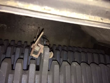

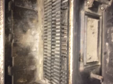

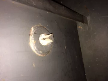

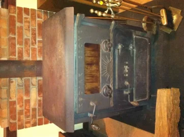

Hello fellow members. I'm new to the forum and rural living lol. We bought a house that has a stove in it. But we are not sure if it's for only burning wood or can we burn coal as well. I know it's a Alaska Kodiak and has a knob for a handle on the side and the lower tray has these grate looking things. But the inside of the stove currently has all brick... Here is some pics

Coal burner. You can burn wood in it too, but it will likely eat you outta house n home!
Are you sure? Only reason why I ask is there's nothing but brick inside of the oven. Do I remove that then put some coal in there? Also I thought the piping had to be ceramic I don't think this one is... Thanks
Never ever seen nor heard of any wood burning stove with all that coal handling equipment built in. Sure looks a lot like this:

Hello this I Robert from Roberts Projects. There needs to be brick on the sides. I'm not sure what you are referring to by the floor. You put the coal directly on the iron grates, and the ash falls to the bottom. Are the bricks under the grates, in the ash area? If so they are likely to insulate the bottom and prevent the floor of your room from getting too hot. You burn Nut coal in these. Living in Pennsylvania, anthracite coal is plentiful and cheap, about $200/ton. I heat a 1600 square foot house with mine and use 3 or 4 tons a year. If you burn wood do not burn it directly on the grates, for it can damage them. That is advice given directly to me when I visited the Alaska factory in Bloomsburg PA a few years ago. I have a 1/4 inch steel plate with about 10 one inch holes drilled in it that I lay on the grates when burning wood. You start coal with a wood fire, but it is not big enough to overheat the grates. I generally fill my stove with 3 - 4 buckets at a time, and it will burn steady for 12 hours. Ideally you keep the stove going continuously for starting coal is a pain. I am able to fill my stove and then lower the fire enough to make it last over 24 hours and be hot enough to light fresh coals. This way I have to re light the stove only a few times over the winter.
Those are your coal grates. You put the coal directly on them. Since there was a plate in there, the previous owners were burning wood. I found it interesting that the picture of the bottom of your grates looked like they were never used for coal because they were so clean. If you have a local coal dealer, they may have it in 50 pound bags. While more expensive than getting a couple of tons dumped in your yard, it is a convenient way of trying coal.
