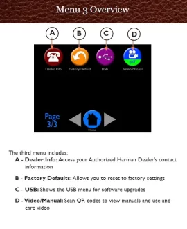

I don't think there was mention of trying a reset of the stove to 'Factory Defaults'(?). If just unplugged from the wall the stove will likely retain settings and any glitches (stuck bits & bytes) that may have occurred , but a factory reset will clear the settings and should as well as any stuck errors/faults (maybe ;hm)

there is an update for this stove. i just updated mine after i installed it last Tuesday. problem was the update on the drive that came with it did not work. "file not found" and there was not enough room to unzip the new file. i had to reformate drive, down load file from Harman web site, unzip it on drive and then i was able to update stove. i don't know if the update will fix the above problem, but it's worth trying
Thanks for the help. I did change it back to factory setting and also unplugged it. I went to the dealer and set up an appointment on Monday and then of course, the stove started working right Monday night before my appointment. It is still working as it should but I am not going to hold my breath thinking it is fixed. It has not worked right since the day I got it.
