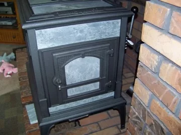

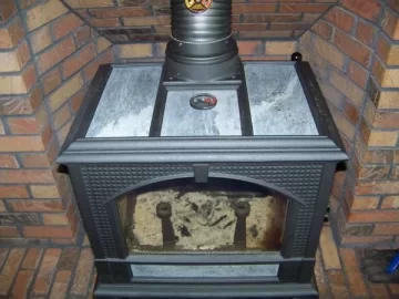

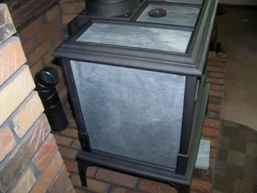

(I want Todd to take some more shots of his Keystone to show the stone in the sides.) I don't find soapstone itself to look fancy, maybe luxurious. To me, the look of the Keystone suggests "understated lux" more than "wicked fancy."
Ask and you shall receive. :-)

Yeah, I definitely like this design better than the Fireview . . . looks nice Todd.
