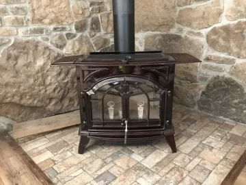

I forget who, but a member did a porcelain finish on a BK ashford, it was a dark red cherry finish and looked excellent
Mine had several chips from the previous owner. After I touched them up its hard to find them. I prefer the porcelain because it always looks new and clean, even if it is more fragile.

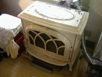

Yes but that stove either had a bad enamel coat or was abused in some way. Spilling cold water on the top of a hot enameled stove will do that
Reactions: jotulguy
It most certainly was abused! There's no enamel left on the flue collar. Damage like that won't happen if it's ran properly and half way taken care of.
Yes exactly. That doesn't happen easily unless it was a bad enamel job but jotul is usually top notch when it comes to their enamel
