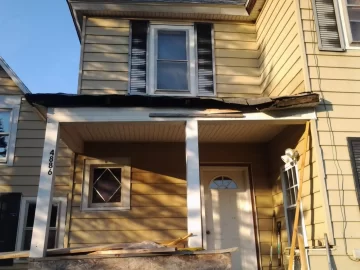

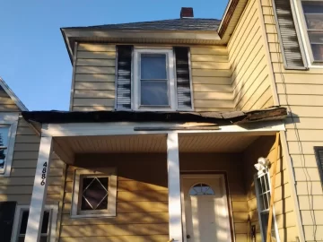

ok, I know my porch roof needs something done with it. I have want for a couple of years now to just take it down. Well, a piece of facia came off above this when they did the upper roof. Guy said today they can't get up on the porch roof to fix the facia because it is all rotted.
Again I say just tear it down and make a nice little deck. I guess my concern after i tear it down, how will i fix the area behind the frame where there will be no siding. There definetly wont be a match for my aluminum siding. So what would I do to patch these areas..
I have some thoughts but would like to hear some of yours. I really need to get that facia put back on, on the upper roof so water don't get in there.
Replacing it really is out the the question right now. and I don't want to jimmy it,,

You could use siding from a less visible area, and put the new siding where it won't show too much. Or put new siding over the whole area, it would be less noticeable that way. The older siding would be a better match than new. A neighbor of mine used siding from the back of his house, so it wasn't visible from the street.
Most folks would love to have a roof over their porch, so make sure you really want to go without. Rain, snow etc, without the roof there, won't be that area to enter that ain't soaking wet or buried in snow all the way to the door. If you want the porch roof gone, just take it down, and put a barge board where the old framing met the house wall, then cap the barge board with same color metal capping as the rest of the house. Make sure to properly flash it at the top so no water intrusion occurs behind it.
Repairing it is the correct thing to do. Taking it off will greatly effect the value of the house. Realize there are also no gutters on the upper roof and the rain will come pouring down causing more damage to the existing siding, doors and windows in the area. The cost to remove it and repair the remaining siding will probably be the same to repair it.

Weeeell, repairing / making it new will cost around $3000. Demo would cost me around $100 if I did it myself.
I am totally out of money at this point. I was thinking about Demoing it, put up a new frame boarder ( what ever the technically word is) that goes around / on the house and making sure that is sealed good so water does not get in. Then after my wife starts her job in july, putting a roof back on I guess.
I just don't know what else to do. The Roofing company won't / can't put the facia back on up top with out this being done. My father in law said he could do it, but I would be afraid if the roofing company didn't do it, it would void the warranty on the roof.

Yeah, I will have to atleast take the roof off to see. The guy said the front header was completely rotted. He was pulling hands full out.
If only the front header is gone, (looks like at least one piece of sheathing also), a new one could be installed without replacing the entire structure.

Look at the main roof above there. You've got that valley with all the rain coming down onto the porch roof. Without the porch roof, it's all coming down over the front door. If you take it off, you'd have to put up gutters and downspouts on the main roof.
Taking that porch roof off would be a big mistake.
