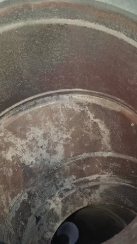

Hello I have a blazeking ashford 30.1. I had a little bit of a scare yesterday. I started a fire trying the top down start. All seemed well then about 5 minutes after I started the fire the house filled with smoke. I went outside and I didn't see any smoke coming from the chimney. But it was very windy outside. It smelled like the paint was burning from the chimney but couldn't really tell where the smoke was coming from. There really wasn't a roaring fire in the stove. I remember reading on here to open the door all the way if you thought you had a chimney fire. So I did that then took all the wood out of the stove. The stove never really warmed up so I took a section of the double wall pipe down to look things over and everything seemed ok. How do I know if I had a chimney fire. I cleaned the chimney at the beginning of the season and im burning soft maple and cherry that has has been split and stacked for over 18 months. When I looked things over the chimney almost looked too clean for burning 24/7 for the past 4 months. Ill post a picture to see what you guys think. The picture is of the 2 offset 45s where they meet the ceiling box.
Edit. I Never heard the roaring sound that I have read about with chimney fires. This all happened so fast if there was a fire it only lasted a few minutes.
You sure the chimney isn't plugged by some critter? Seems like it was based on your description, no smoke out of the chimney and smoke backdrafting into the house.
Craig
That was my first thought. But when I took the section of pipe down. I could see all the way to the top and it was clear. After I checked everything out I started another fire but not using the top down method and everything was fine.

I will say the pic of your pipe does not look like a typical chimney fire but it could be if there was not much fuel for it. Regardless just check everything over good it will probably be just fine it does not sound like it was a bad fire if at all and class a chimneys should be able to stand up to it occasionally especially minor ones like you may have had.

I don't see any sign of a chimney fire in that picture. Whenever I deal with cleaning up after a chimney fire there is always expanded creosote around and part or parts of the chimney will be filthy with creosote. What's pictured looks quite clean to me. If you see no deformation in the interior of your pipe and it's clean like that to the top you should be good to go. Based on the instal is to code in the first place.

Everything looked normal when I looked it over. There seems to be some build up on the top foot or so of the chimney. Not alot but some.
