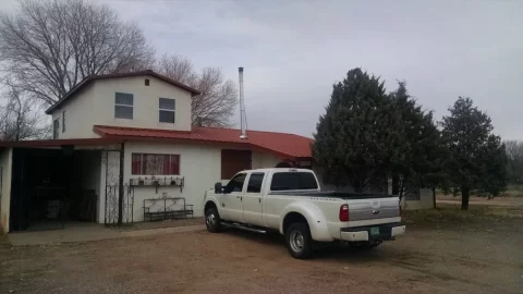

I do have a 3 foot section of chimney that I can add. It just already looks ridiculous with the 8 feet sticking up out of the roof. This is the first time this has ever happened so i dont know if it's draft related or the super windy conditions were to blame.
I understand.lol I have like 12 ft over the roof.lol but it works good.

Is it bad that I checked out the truck before I even noticed the chimney?
I would like to add my extra 3 feet I have but bit finding someone to do it has been hard. Also I would need another brace.
3......2......1......we have lift-off! ;lol
Eyesocket, what's with the trees?? I didn't think there were any in NM....is the river right behind your house? ;)
In the land we have a river plus irrigation. lot of water;)
Reactions: Woody Stover
lol. I have to install another brace and i have it, I just need to make some time and do it cause here the wind can get nasty sometimes
Near my sister's in Socorro there are trees along the Rio Grande, especially at the Bosque del Apache National Wildlife Refuge, but they are sparse once you get away from the river. For me, going out there is almost like going to a different planet. _g
Near my sister's in Socorro, there are trees along the Rio Grande, especially at the Bosque del Apache National Wildlife Refuge, but they are sparse once you get away from the river. For me, going out there is almost like going to a different planet. _g
Down here you can find a little bit of everything. it depend the areas.
