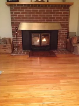

I have done a lot of research on different manufacturers as well as designs of current model stoves. If I decide to go with something other than a Vermont Castings, it will most likely be a Lopi. I am considering the Liberty and the Endeavor. Due to the fact that the house is only 1654 Sq Ft which would be a better fit? The stove will be going where the existing insert is and I will close up the opening and put down a bigger hearth pad. Without being at the house I can only provide whatever pictures that I have if anyone needs to see the rooms.
Here is the current insert.
ETA: I don't think that I will run into problems with clearances.
As a fellow Liberty owner I will tell you right now it is too big for 1654 sq ft. I keeps my 2400 sq ft house in the mid to upper 80s. and stove temps usually run 650 to 750. The endeavor would be a better fit
Any major differences between the Liberty and Endeavor? How long have you had your stove? What kind of realistic burn times can I expect with the Endeavor?
No major difference in the liberty and endeavor one is just bigger than the other. This is year 4 with my liberty and can get 8 to 12 burns depending on how much I fill it. I would think you could get 8 to 10 hours out of the endavor
