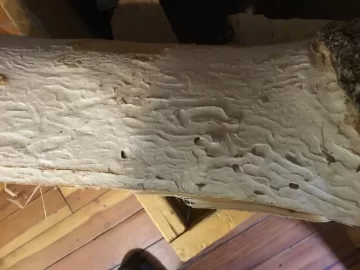

Anyone recognize these signs? A lot of fine powdered dust shakes out from under the bark. Maybe bark or powder post beetles?
Not powder post beetles. It’s not something that we have here. I suspect it’s a beetle, but could also be a parasitic wasp. Some of their larvae bore into wood. I’d ask an entomologist at your local college or extension.
Reactions: Pinesmoke
