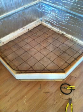

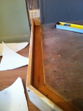

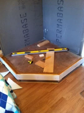

Hi Guys,
I just signed up to this forum as I am installing a new wood stove "Jotul F100" and I built my hearth 8 inches above the ground and its going to be installed in a corner. I made a form and plan on pooring cement right in approx inches thick and then I plan to acid wash it and polish it. Will normal Sand Mix cement work for this. I have seen counter top concrete but it is 50$ a bag and way too expensive. Some people have recommended mortar but i dont think thats a good idea. Looking forward to your opinions on this

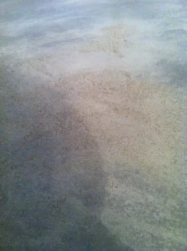

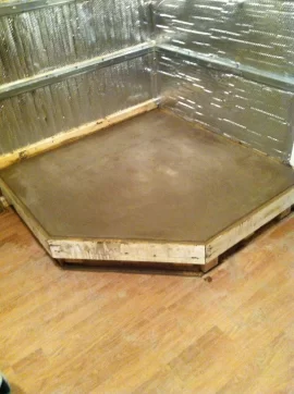

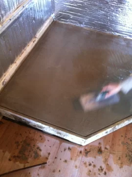

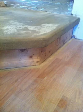

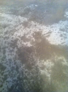

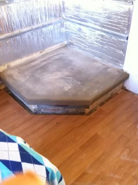

Thanks for all the replies everyone. I did poor my slab last weekend. (Pics Below) I just bought sand mix for the job. I wanted to keep it cost effective. I will be letting it dry for 7 days as it is my country home but I am really wondering how to finish this now. I have been reading up a lot and some people say to use muriatic acid on it ro remove the "paste". If I do choose to do this would i do it before or after i sand.
I also wanted to get honest opinions here. Can i use my normal orbital sander. This is all I have and I am not to go out and buy a wet polisher and diamond blades for a small hearth. I have a normal sander and bought a whole stack of 240 grit sanding disks. Will the sand just keep breaking off or do you think after the 7 days it will be able to sand down to that "glassy look" ? I tries to upload some pis so you guys get a good idea of what I am working with.
As the final step after i apply the sealer i will be polishing it with a buffer and carnuba wax

Sorry it took so long to respond. I've never used the acid to remove any paste. After letting it cure, I've gone straight to polishing. The table I'm working on now, I will wet sand working up from 100 or so, to 1000 grit, then buff. I've gone up to 400 in the past with smooth results. I think the 240 will get you smooth but I don't think glossy smooth.
I plan on making more and think it will be better (for me) to get the wet polisher and pads.
