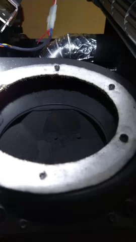

Hi,
I started another thread about my PP 60 not able to maintain a burn at LO for extended period of time. I read your thread and removed the exhaust fan and took a picture of the fan case. As you can see, the two screws are what is holding the sensor to the exhaust pipe. The sensor is on the other side of the pipe wall and I don't see how the ash would interfere with the sensor.
Regardless I scraped the pipe wall anyways. Not sure if this will do anything though.

Hi,
After the stove lights, the sensor reads the change in the temp of the exhaust fan housing to verify a flame. If memory serves, it reads a rate of temperature change during the ignition cycle……the ash build up on the inside of the housing acts as insulation so it didn’t sense the temp changing fast enough and it would think the stove didn’t light.
Not sure if cleaning it would fix your issue, but it wouldn’t hurt. I would suggest adjusting the trip setting as well. 3 bags shouldn’t be enough to build up ash to the point of insulation.
