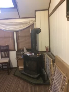

First off hav the clay scanned to be sure it really is ok. But it does look pretty good from above. next does it have the required clearance to combustibles? I can tell you it does not where the paneling is in your pic but if that is the only spot it is easily fixed. But chances are that you have combustibles to close to the outside of the masonry structure. And if that is the case you need an insulated liner.
I assume you mean this picture for the paneling, even if its not i stopped using this because of the clearances. But all the paneling will come off anyway.
That is good but what about the roof framing sheathing ect? And the framing of the walls?
I gotcha so if the roof overhead overlaps the chimney thats a no no cause of the framing laying of the chimney?
If the framing of the roof or walls is withing 2" of the outside of your chimney it does not meet code and it needs a liner. If your chimney was an external one it would only need 1"
