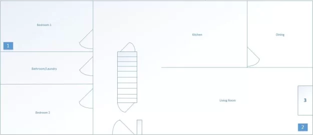

I have a Vermont Castings Defiant Model 1 in my basement. Old, but it will pump heat without a problem and i restored it from a hunk of rust to where it is now. The problem i have is that i can't get the heat to transfer from my basement to my first floor.
Hopefully the image i uploaded can be seen. It's an image of my upstairs. Note that the boxes labelled 1 and 2 are grates in the floor sized at about 24"x12". Also note that there is a central stairwell. The basement is the same square footage as the upstairs but the walls bisecting the area are in the area of where the Bathroom/Laundry and Bedroom 2 would appear... that's my workshop... have to keep the cats out.
I can get the basement cooking. 80 degrees or more without an issue. However, the warm air is not moving despite anything that i've attempted. You can actually walk into the stairwell and hit a wall of hot air. The upper level of my house can be 30 degrees difference in temp.
Now, i've tried blowing air up the stairwell/down the stairwell, blowing air up the floor vents/down the floor vents, turning the kitchen ceiling fan on pulling/pushing, closing off one vent entirely and attempting fans in the vent or stairwell... the heat just is hanging there.
I'm at a loss as to what the issue is and after having spent an entire winter bundled under blankets or spending time in my basement last year, i've kind of met the end of my thoughts on what to do. The only thing i can think of now to heat my home is to forego the basement method altogether and install an insert in my fireplace (designated by the #3 in my livingroom on the right of the house). Opening at 33Wx28Tx26D tapering with a small rectangular damper.
Admittedly... i'm a bit overwhelmed by the choices on the market and reading the umpteen reviews on this site has made my choice action more difficult instead of helping. I have limited funding, in and around 1-2k to furnish an insert, but i can't help but scratch my head about my current installation and why i'm having such a problem. Heat rises... but in my house the laws of nature don't seem to apply.
Am i doing something glaringly wrong here? Best if i just say screw it and put the money into an insert?

Wow you do seem to be defying the laws of physics, especially since you have the two big grates and an insulated basement. I have friends who heat their entire 2 story house from their basement with a Fisher Papa Bear and roast all winter, and the house is way bigger than 1500 sq ft so know it can be done. He does not have any grates and uses no fans, and the stove is located pretty close to the bottom of stairway in the basement. The stairway is central to the house, like yours.
The only thing I can think of is you have some kind of weird airflow issue that is preventing the heat from naturally rising. Is your basement ceiling insulated?
I am sure someone will be along who has a setup similar to yours and can help.
Is your upstairs really airtight and well insulated? Where in the basement is the stove located? Is there any air moving through the grates? (e. g. checked with some incense stick?) Any idea where the air for the stove is coming from?
To fire_mans question... there Was a drop ceiling I n the basement that I pulled down to keep the heat from trapping. Only thing between the basement and upstairs now is the subfloor and the oak hardwood I laid above that.
To Grisu the upstairs is well insulated and retainsheat well for that matter. All windows are covered and the attic stairwell that shares the basement stair on the top side has an insulator blanket keeping the airflow stopped.
The stove itself is located about 5ft north downstairs of where I've labeled the fireplace.
There is a small amount of air coming from both the cellar way as well as the floor vent in the living room, though it is mostly cool. Vent in bedroom 1 is stagnant. I have tried both the stairwell as well as the living room as the primary warm air flow point though the air movement is so slight that it is not enough to heat the upstairs.

Also putting a small fan on the floor blowing the cold floor level air down the stairs into the basement will help the current setup. The warm air will flow up out of the basement as it is displaced by the cooler air blowing down.

I have the same setup as you almost, however instead of a step staircase I have a circular staircase in almost the same spot. I have a ceiling fan over the circular staircase. And also my Chimney and Stove are central directly next to the stair case. I have two floor registers direct above the stove.
The ceiling fan directly over the spiral stair case blows cold air down into the basement. Then in turn there is a strong updraft through the two registers directly over the stove.
Typically I can get upstairs around 73-74 when it is 25-30degrees outside. It is tough maintaining 70 upstairs when it is 15 and below. When the power goes out I can only get upstairs to 67-68 no matter what. So that is the difference air flow makes.
You have a more difficult situation because you want the warm air to not only rise but coarse across from one side of the house to the other. I think it is possible but it may take more experimentation?
Can you install a ceiling fan over the stair case having it blow down? Possibly install another ceiling fan over the stove/register area drawing warm air up? Are your floor registers directly over the stove? Can you put another one in over the stove?
For me it has really been all about proper airflow but I think my setup is more ideal than yours (spiral staircase with ceiling fan over it, central stove/chimney, central registers)
Yeah, blow the air on an angle down the stairs. I have a box fan with a very thin wire that holds it on angle blow down the stairs. The fan is on the same plane or angle as the stairs, it works wonderfully! I tried blowing all ways and found this to be the absolutely best. The wife hated it at first but now she feels the difference... So try that.

This is a reason basement installation is often not recommended unless the basement is your primary residence. I knew i was taking a gamble installing my stove downstairs but The Encore was the appropriate size to heat 1800 square feet which I have but it is imperative good airflow is achieved and I knew my spiral staircase was going to be superior especially with a ceiling fan above it. If I had a normal stair case closed on both sides I would have been more strongly considering either an upstairs install or a second small stove upstairs in addition to downstairs.

I guess that is your problem. The hot air from the basement would like to move upstairs but the cold air there has to go somewhere. In not so well airsealed houses you get a stack effect with cold air coming into the basement and warm air going out the attic which creates an airflow that would also pull warm air from a stove upstairs. You would need to look at getting the cold air from upstairs down. When do you start the fan? When do you just light the stove or when it is already warm downstairs? Maybe try to get a convective loop going early with a fan at the stairs blowing air into the basement and keep vent 2 open. I am also wondering whether cracking some windows upstairs may also help.

If using air as a your heat transfer medium, you'd probably be best off "Grabbing" the air close to the stove where it is very hot and getting is upstairs with as little turbulence as possible. The walls of your basement are probably ~55F and that stove is creating big eddy currents that are possible transfering more heat through your basement wall tank upstairs.

At that point you may have already "layered" the air and it may be tough to break that. Maybe try starting the fan just after lighting the stove. You want to establish a current that the stove pulls cold air in and the warm air flows upstairs. How are temps actually before you make a fire?
Cold air is denser and therefore easier to move than warm air. We usually recommend to get heat to an area by having a small desktop fan blowing cold air towards the stove. The warm air from the stove will then travel into the space that the cold air vacated, thereby generating a convective current. You have to look for ways to get the cold air from upstairs somehow into the basement and towards the stove. The warm air will then travel by itself to the upstairs.
