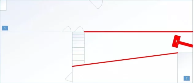

So... basement view... 3 being my stove location. Vent 2 is within an open closet that houses the boiler (open double door and open ceiling to the rest of the basement).
You're saying create a temporary wall (the red lines), more or less, between my stove and the stairway to focus the heat in one direction. If i effectively sealed the basement in half along the i-beam that runs the length of the house where would the cold air return be? The floor vents would be segregated from the stove. Wouldnt that cause an issue displacing the cold air upstairs with the warm air from the stairwell?

Leave about a 5" gap at floor level over close to the stove. Or just don't take the sheets all the way to the wall behind the stove. Or both.
That plus your fans pushing cold air down to the basement and you'll get an idea really quickly what the possibilities are.
That might be better, sure, but try it and see. You'll be surprised.

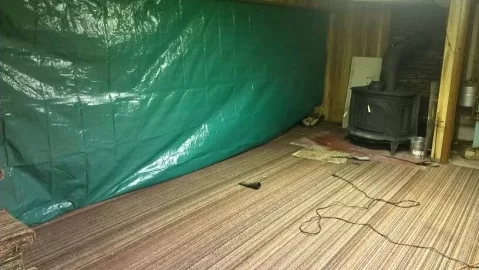

12x20 tarp spanned the area nicely. Tacked to the ibeam and walls,extra length pinned to the floor. May not be a good test night though. Still about 40 degrees outside, though the temp has risen 7 degrees in the past 20 minutes.
Yeah..I know the carpet is ugly.

Get a fan blowing down your "#1" hole and another blowing down your "#2" hole, lift up the tarp a little more in that corner, and you're in there like swimwear.
Good Googa-Mooga, with the size of that stove you should have no problem. As I sit and type my NC30 is doing exactly what I'm (hopefully) explaining.
Oh, and don't pay too much attention to the outside temp. Right now it's about 35 where I am and upstairs is steady at 73.
Note: If you have two different-sized fans, then put the larger one over at hole #1.
Been testing out the basement bisection for the last few days. Its been pretty cold in the teens and 20s. Keeping the heated air separate from the cold down draft is a complete win. 70 degrees plus inside and the warming time from a cold start is much quicker.
