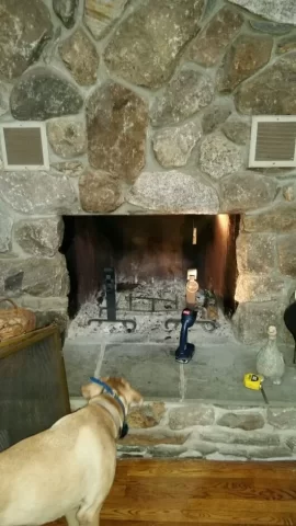

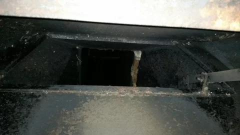

In the quest for more efficiency, my new strategy is to put a Princess insert into the main floor fireplace. With the exception of the flue door, it is a straight 15' or so up 12" by 12" tile. The tricky part is to get through the flue door, either by bending pipe, having some kind of angled retangular pipe, or cutting up the metal fireplace. I'd like recommendations on what kind of pipe to run as well. Looking forward to your advice. Here are some pics.

cut out the fireplace
Let me add that cutting out the fireplace is not my most preferred strategy.
It may not be preferred but it is the best solution by far. Also have you had a sweep out to look at the other flue? There is usually a way to get a liner in.

Make nice clean cuts and the parts can be welded back in
I had the same deal your working with. I used a grinder with a cutoff wheel to make room for my insulated flex. Couple tips if you choose this route make the hole big cause your going to need some room to guide the flex to your insert. Also clean the inside as best you can before you start grinding saves your eyes. I used flex king HD for my liner and my princess insert drafts very well even in the 50+ degree weather. I'm sure you know but having everything checked out and cleaned before your installation is just a way to make sure everything is safe.

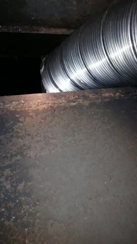

Cheaper for me because I already have the liner and just need the insulation and the fitting to the stove. I was able to get a piece through my flue. It seems very tempting to try this without cutting up the fireplace.

If it will fit through the existing damper opening then there is no need to cut it out. Just be careful installing it.
If you can fit it through and fit it onto the stove then no reason to cut it but i have yet to put an insert in a heatform box that did not need cut in order to get the liner to line up. Yours might work though i dont know
There will be a bend and maybe too much to hook it up. Your probably right.
I may be wrong also it is worth trying it without cutting the box out
