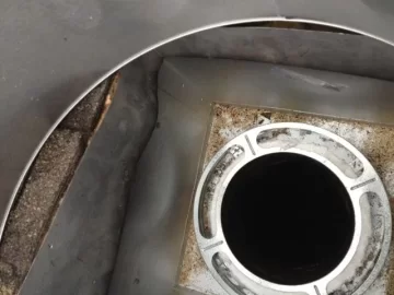

The one thing I'd want to check is that you have a cap to prevent stuff from falling inside your ceiling support box. I've seen a few installations where people have neglected to put any cap around the top of the support box, and that opens the possibility for stuff to get inside the box and end up right next to the chimney.
yea I believe its all there Lumber jack, here's a pic. theres an oversize aluminum sheet with a "corrugated" flange that received the class a pipe, then after that the angled ring sits above the joint

Lumberjack was referring to a cover for the ceiling support box. It's called an attic insulation shield. It would be in the attic, can you take a look in there?
Does your chimney transition through an open attic space? Or do you have a cathedral ceiling?
It is usually the support boxes in open attic space where I've seen boxes left open. You can see this one has a cap on the top, I've seen some installation that didn't have that cap.

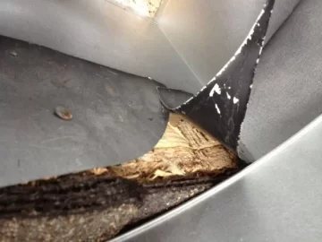

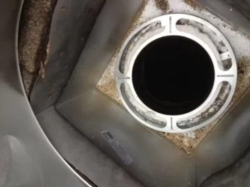

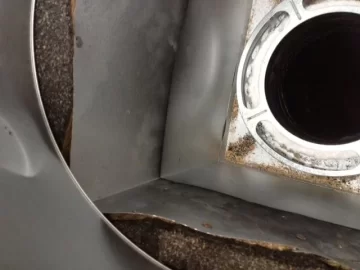

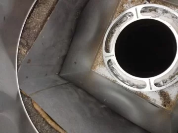

UPDATE
so the weather broke today so i went up and took everything apart and to my pleasure, i find everything to be functioning properly. I did take several pics and hopefully Begreen who mentioned there may be something in the support box but i found a minute amount of dawdust. (removed the dust)
I did find the installer did a sh*&tty job of hacking together a support box. If anyone can chime in on whether this is cosmetic or something that needs rectified. in a few of the pics, behind the sliver of support box where he cut 2 to make it fit, i see a little black. i do not think its char, its either black paint from the back side of the support box or a little heat from cutting the hole in the roof. its the ONLY place it appears around either joist flanking the support box.
