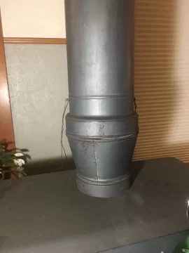

(3) I believe the flue is too tall. I haven't measured the exact distance, but it goes up through two stories.
(4) When I swept the chimney before this burning season, I realized that the flue has a larger diameter than I am used to. Additionally, the diameter increases right above the chimney. My understanding is that an increase in diameter can increase pressure and contribute to an over draft (and I assume a wider diameter is creates a larger draft anyway).
