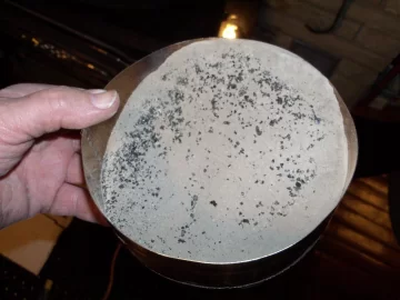

I cleaned out my chimmney liner the other day and got probably 2 coffee cups full of white powderish stuff which I thought was really good for 1 1/2 years burning. The black specs is from tapping on the top cap after putting it back on. I did get about another handful of the white powder off the top of the insulation blanket. Would I buy it again? Sure I would. Love my big NC 30 in the drafty garage but the Quad Yosemite makes me warm and comy in my easy chair:cool:.

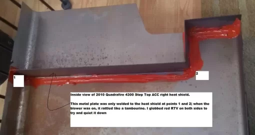

-The heat shields rattle when the blower is on. Given that this is a "jacketed convection stove", operating it without the $290.00 blower is not an option. Upon removal of the heat shields, I found that a support brace had been inadequately welded and was the cause of rattling on that side of the stove (it rattles on both sides). I globbed Red RTV on both sides of the brace and it has calmed down on that side. the other side still rattles.

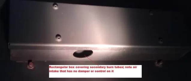

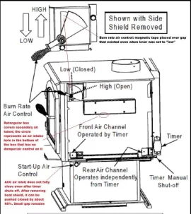

-I have double wall stove pipe and double wall insulated chimney pipe, along with an outside air kit. The stove is very difficult to control, although I understand this is systemic to many EPA tube stoves. I used magnetic tape to block off some of the primary and secondary air inlets which has helped some. The secondary inlet had no control/damper on it at all.
