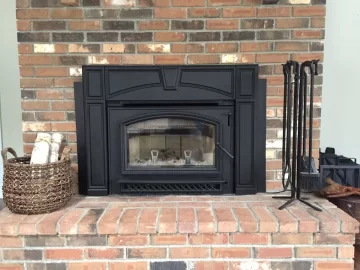

I'll pipe in as well. I just had a Voyageur Grand installed over Thanksgiving. With the warm weather I've only burned it a handful of times, but here's my impression.
Looks wise, it's about a good looking an insert as I've ever seen. Although I did have some flaking paint on the on the front of the insert after the first burn but it was minor and nothing that a can of high temp black paint couldn't fix.
Performance wise, while I'm still learning to use it, the info I found on this forum has been really helpful. I did learn a valuable less regarding seasoned wood. I had some wood left over (seasoned 1.5 years) for my first few burns. Startup, and heat output were very good. I have a 2500 sq ft two-story home built in the mid 90's with a 30ft chimney, outside temp was 35F, room temp was 75F, all rooms downstairs were 68F+, and all rooms upstairs were 68F+ (Note: I ran the fan in the room with the insert and ran the circulating fans only on my HVAC systems). The head had not run most of the night. When I ran out of my wood, I ordered a new load of "seasoned" wood that turned out to be fairly wet (a moisture meter is on my Christmas list :) ), but as I would reload the wood would sizzle and hiss. I had to supplement with smaller splits to keep the fire going and the heat output was terrible. So the lesson I learned is that fuel quality is key to good performance.
A few pointers / notes to Voyageur owners (not in that poorly written document package provided with the insert):
- ACC (automatic combustion control) - To start the ACC push all the way in, pull all the way out, and if the room is quiet you can hear the timer clicking. Note: The nob does NOT automatically pull back in as the time ticks down.
- Rattle when running the fan - Mine rattled like crazy. Mine ended up being the pull out metal safety cards that are underneath the two blowers. To access the cards, open the door to access the fan control. Remove the upper bolts holding the frame around the blowers in place. Remove the frame by pulling straight out. Below each blower you will see a metal handle. Pull the handle and you will notice these are thin sheets of metal with warning instructions on them. One of mine was bent in several places such that it would not lay flat in the bay, thus causing the rattle. I straightened the sheet out and reinserted it properly and viola I'm now rattle free!
- Loud Fan Noise - yes it is fairly loud at high speeds, but I don't find it intolerable. One thing that comes to mind is because this is a flush mount you do need to run the fan at higher speeds to compensate for the reduced radiant heat when compared to inserts that extend onto the hearth.
- Dirty Glass - My experience, seasoned wood no issues with dirty glass (maybe a bit around the edges as the fire burned down), unseasoned wood = low temp and dirty burn = dirty glass.
Overall I love the insert. It's everything I was looking for. My priorities were #1 capture some of heat being lost up the chimney with my old drafty fireplace, #2 maintain a good view of the fire, #3 supplement my central heating a bit when possible.

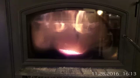

Hello all. I'm not sure if it's bad etiquette reviving old threads (honestly I am not sure) but I'm going to anyway.
I personally have a high valley 2500 insert, which came with the house. I had never had stoves before, so I thank everyone on here for the VITAL education. It's about 20 years old, and I can only assume that the cats are original. The prior owners left me with a "slam install" that the home inspection never mentioned, but after having a new liner installed, I absolutely love this thing.
Which leads me to the voyager grand.
My in laws, after seeing our stove, purchased a v grand, and being relied on heavily for technical advise on many fronts, I had to learn how to run this thing.
So far I'm sad to say I'm not impressed, if only for the dirty glass. Now, as a disclaimer, I continually scold my f.i.l. for burning less than seasoned wood. So for future readers, this is a known factor that if I can see corrected, I will post any improvement in glass filth, aka the "butt print". I also can't help but think those iron stakes in front help cool the air, hurting the hot air wash of the glass.
Though my biggest complaint is the glass filth (which I'm hoping is the few month seasoned wood), I'm also concerned with burn times. I think 6 hours is his average burn time, and he has told me that it is deceiving at low burn since the coals get burried in all the ash.
I know it is apples and oranges with cat vs tubes. And also the v grand is being ran but not one but two amateurs. AND the v grand is being fed what I would consider unseasoned wood. AAANNNDDD this is only their second year burning in it. But.....
I feel that the learning curve is quite step with this one, especially since there are no thermometers on it. I'm not even sure where I would shoot this one for a revealing temp. *thoughts?
So to be fair, I am still working on getting him to rotate his wood pile. But is there any advice on what Temps we should see, and where are you shooting those Temps at? I also think that they might be cutting the air too early and not getting to a proper temp in the first place.

The problems you are having are due to the wood quality. Dirty glass will happen every time with wet wood. The stove is designed to work with seasoned wood.
JA600L
Nov 30, 2013
1,288
Lancaster Pennsylvania
The less than seasoned wood is causing less secondary combustion and requiring more primary air. As a result the wood is being consumed faster than it would if the off gassing of well seasoned wood were happening. A large amount of the heat produced is going right up the chimney.

I'm 99% sure most if not all of these problems are directly due to the wood quality. If I could get him to rotate his wood pile yearly then I would be a solid 100%. When the stove runs hot it does seem to wash itself for the most part. It still has a butt print but considering the hurdles it's going through, I guess it's not so bad.
Would I be out of line to say that it's definately not as forgiving as a cat stove? I do season my wood, but I have burned wetter wood in it without as much fuss as his stove gives.
Also, I don't seem to need to shovel mine nearly as often as his. But again, inefficient burning = more ash. (Hey look ma! I learned something)
