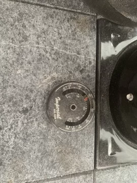

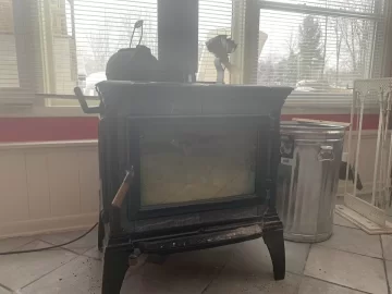

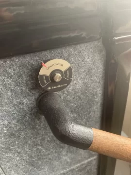

We installed out stove in oct 2020. We are brand new to freestanding stoves, so not 100% familiar with the length and terms of the stove. Our wood is dry, we have a moisture meter that reads less than 10% on our wood. We have noticed that once the catalyst is active and we close it, the fire inside the box completely dies! When we open the converter and open the side loading to get a draft, the stove roars to life, but then quits once everything is shut. There is little smoke in the box, but it’s black. Please help!

Load stove up and light the fire, making sure the primary air control (below the door on the left side) is opened all the way to the left, by-pass handle is also in the open position (located on the right side of the stove body near the top rear)
You let the fire do its thing then when the catalyst is in the active zone you close the by-pass handle, with the primary air open you should see the flames going really well, after the cat probe needle settles into a high burn start cutting air back (move the primary control to the right) this should reduce the flames in the box and create a gentle flame show and provide a slow steady heat output.
