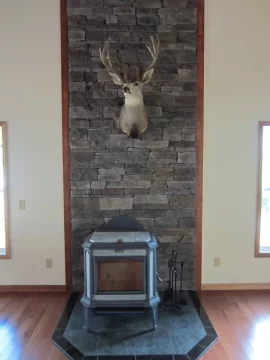

Rideau, GET THE ASHPAN! You can't even see my ahspan, of course my stove is sitting on pretty dark colored slat tile, so maybe that is why, it blends in. But seriously, you really can't see the thing. I also have the front ash lip, that also hides it a bit. BUT, having said all that, the ahpan works sooooooo well, I really can't see onwing this particular stove without it. It's huge, easy to use, works really well. Then throw in it might solve your other issue, GET IT already! ;)

Like Machria says, you really don't notice the ash pan very much. If I were to get the optional ash lip, I don't think you would notice it at all. Click on the picture I have attached and judge for yourself.
