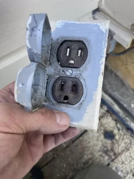

Spring maintenance on the cabin time. I’m replacing some Dutch lap boards, reflashing a doorway, and other odds and ends I’ve been neglecting. I went to pull the cover off a receptacle so I could more easily cut around it to replace the board. I don’t think that’s how it is supposed to come apart, lol.
Atleast yours was in a box. Mine was just the plate with holes drilled to attach directly to the vinyl siding. No box exposed connections etc. But hey it was a gfci lol.
This house is a 70s ranch and I have had relatively few surprises. My last house was a 150 year old Victorian ish house that had been splits into an over under rental for 50 years. All kinds of fun surprises there
This happens, sometimes even to new outlets. Fortunately the fix is easy, just replace with a new receptacle.
It looks like the porch flashing has created a water trap at the base of the siding. Adding a Z flashing under the bottom course of siding that overlaps the porch flashing will direct the water away from the sill.

I screwed up the flashing about a decade ago and caused the issue I’m fixing now. I know more and will fix it right this time.

That’s what I plan to do. My wife will be bringing up my brake and a roll of trim coil tomorrow.

I ended up putting a surface mount box on and installing a GFI inside it.
That outlet came out piece by piece! I’ve never had one do that!
Tomorrow I’ll be able flash it and close the spot where the outlet was. The wood was fairly dry. The front is much drier now, but still needs time to dry. It’ll probably be open for a couple/few weeks. I want as much moisture out as I can get! Only a little more wood needed to come out. Unfortunately it was flooring. Fortunately it should all get covered up with the new threshold.
