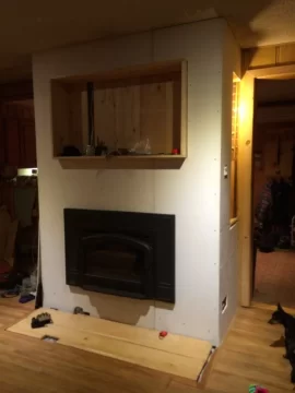

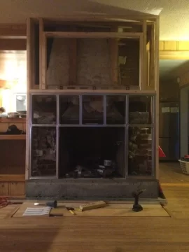

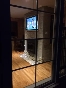

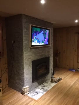

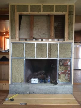

I've ordered Stone Veneer from Eldorado stone (Mountain ledge panel Pionner color). You're right for the wiring, i'll be using 2.5 in ABS plumbing pipe. For the backerboard i know it look like sheet rock, but in fact it's MgO board or Oxyde magnesium board. I went to buy cement board, and after explaining my project, the guy at the shop sell me this. He said it as pretty good properties as fire resistance as the cement board, but lighter and it as already a waterbarrier for the mortar application.Looking good. What stone will be used? What backerboard is being used for the stone veneer?
Hint, leave a permanent access port on the side for TV wiring, maybe hidden behind a picture.
