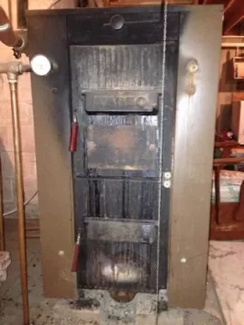

We called it the pig. It burned 22 cords in a year!
[Hearth.com] Pros-Cons traditional wood boiler vs. Gassification?
This one burned 16 cords a year without storage and 10 cords a year with storage!
The Jetstream was our first successful Gasification boiler with storage. It averaged 4 cords a year over 35 years.
Over 35 years, gasification with storage burned 630 less cords of wood. You would have to force me to use something like the pig !
. . . . Old traditional water heaters -- Con's Used a lot of wood,yea used a lot of wood,bad smoke for your neighbors,short lifespan because of the design. . . .
I disagree with short life span. My Tarm MB 55 that I installed in 1980 is heating my house today, after 42 years of service. I use it every winter. The only part I replaced was the Samson draft regulator thermal sensor that is use to control the draft damper. Wood usage is not that bad. It is not a problem for me.
