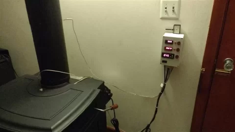

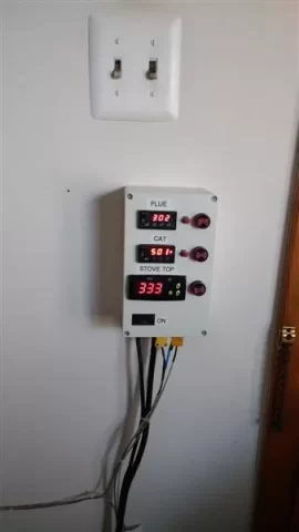

Rule number one, don't leave the room on a "hot" restart, and start fiddling with something else. That hot metal smell will remind you in a hurry that your air control is still wide open.
), with the controller if the alarm sounds I just turn the stove thermostat down a bit and the temp will quickly decrease.
-700
