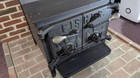

Hello everyone, I'm Tim... A brand new member here and a new owner of a beautiful Fisher Grandma bear stove.
I grew up with a wood stove in my home (better'N Bens')and love them. I just picked up a really nice grandma bear off craigslist yesterday. Drove 3 hours 1 way. The stove is in really great shape. I love it already.
Don't hate me but It has an 8" rear flue. I'd really like to convert it to a top flue. I've seen it done on 1 of the smaller single door stoves. I have a great welder here in town that can do this really nice. I will likely have him fabricate a baffle for it as well.
So has anyone had experience with doing such a modification? I wonder if changing the 8 " flue to a 7" or even a 6" would be better?

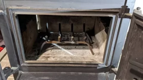

Get rid of the grate. It doesn't look like your hearth is wide enough. And what is behind the brick wall

Those pictures are from the previous owners.
I plan on building a completely different set up and definitely not using the grate. They did throw it in the deal as well as the screen to keep the door open and tools. Shovel, poker brush.

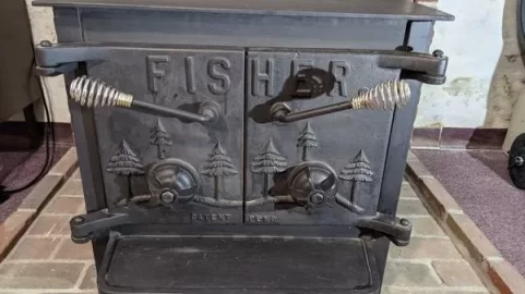

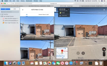

Very common stove from late '77 to 79. The 5 fin dampers and newer spring handles point to 78 or 79.
First, is the outlet pipe welded inside or outside?
It looks like there is no taper at the bottom legs, correct?
You didn't mention where you got the stove from or what part of NY you're from.
I've seen NY and NJ stoves stamped on the back at top corner with NY#xxxxxx as the stove number. PA stoves will have a PA and number in weld on the bottom.
If it has never left your state, chances are it was built by Fisher Stoves 4075 New Court, Syracuse NY. A google web search shows a street view of the existing building.

I took a look at the stove. It looks like it sa PA underneath. Almost looks like it was done in chalk or something. Didn't look like it was welded in. It was hard to tell. Stove is still loaded on my trailer

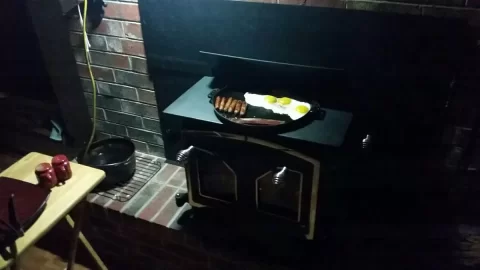

Here's a real 283 square inch cook top for power outages. 13.5 X 21

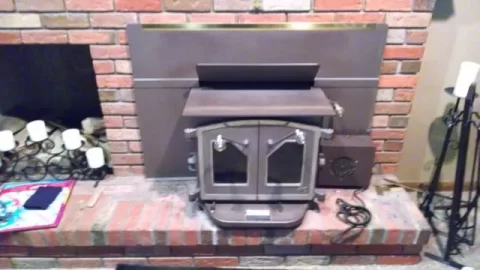

Now that is cool. I'm going to have to try that when I get mine installed.
That was in reference to cooking on a Fisher Insert where new units have little to no cook top.
Yours will get hotter on the upper top with no baffle installed. The front is considered the simmer burner for stews and keeping a tea kettle hot. With a baffle plate installed the front gets hotter than the rear, so cooking is reversed.
The issue cooking on a wood stove is they cook your legs standing close to them for any amount of time compared to a cookstove being built to prevent heat from cooking you.
There are waffle irons, toasters, coffee pots, even stove top ovens for stove top cooking.
