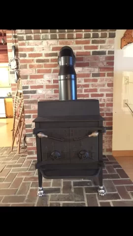

My Grandma top flue is 8" too. I believe Coaly said this was to be able to run with the doos open as a "fireplace". I have an immediate 6" reducer for a 6" chimney and always run with the doors closed. Just put in the Coaly DIY no weld baffle last week and it really moved the heat to the front of stove and comparatively cleaned up the exhaust.

Open doors don't work on mine with the 6". I have to start the fire in a way that will burn for at least 15-20 minutes before opening the doors or it will pour smoke inside. Sometimes even later in the burn I can only open one door to reload. Seems that is a little worse since putting in the baffle. I'm going to try raising the front of it and inch or so before the next fire. It is a shop stove which I use maybe 20 times a year with a sub-standard chimney. YMMV

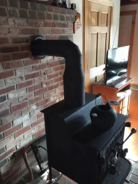

Here’s mine. As you can see I reduced it from 8 inch to 6 inch at about 12 inches above the stove mainly because of the 90 degree elbow going into the chimney. I have an unbelievable draw so the 8 inch damper is used a lot. I also open the doors to watch the fire all the time and even with the baffle installed I get no roll out smoke. Everybody’s application is different. All you can do is do it and see what the effects are. It’s not exact science

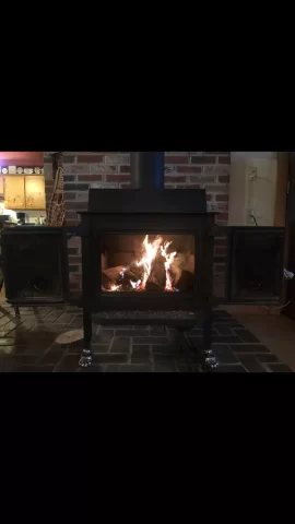

Also the factory screen has a HUGE effect on open door smoke roll out. It has much less square inches of area ( close to 50% ) using the screen in comparison to just open doors. And thus decreases smoke into the room. I use Grandma with open doors .... sometimes with screen and sometimes no screen. But I NEVER LEAVE THE ROOM in either mode. Let the Nay Saying begin!!!
Beautiful setup!! Looks really nice.
Do you have 6" all the way up the chimney? How high is it?
I do have the screen with this stove and I plan to use it
6” into a 8x8 clay lined chimney approximately 30’ tall
Maybe thats the difference. You only have a small section of 6" pipe going back into 8". I would imagine that 6" would be acting like a damper to some extent..? As opposed to going straight up all the way with 6" pipe..
I'm not really sure. I'm just learning this as I go.
Maybe I should just split the difference and go with a 7" flue all the way
Since your all new pipe and will probably be using insulated pipe, if it was me I’d use 8” all the way. Stove is 8” and just include a damper near the stove connection to control the chimney draft. I run mine hot and don’t ever have any creosote buildup. I also use a creosote log a few times a year just for kicks and peace of mind
