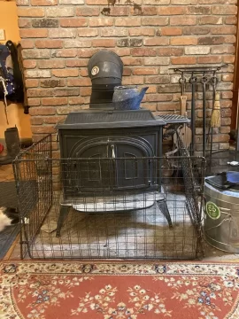

My Vigilant has been in the family since new in 1980 and i have heated my home with it since 2010, so i am familiar with it. Multiple rebuilds, the last probably 5 years ago, new door and top gaskets this fall. I try to maintain prolonged 350-375 stack temp in back burn, i am burning dry (2 years in my basement) oak. With the mild weather we are having it seems worse but have been having back puffing over the last few weeks, tonight it did it 5-6 times in an hour, I opened the secondary about half way, no change, opened the thermostat a little more, got hotter but ultimately did it again once it evened out. I have always hung a fence staple in the primary air intake to prevent this behavior before, keeps it from totally shutting down and sealing off the flapper. The fireback does have a crack, but no distortion, i plan to weld it this spring, still working on getting more made, but have been too busy to move forward with that endeavor. Currently i just loaded it and it’s hovering around 400 and behaving, but I suspect as soon as I go to bed I will smell the back puffing start again.
25’ of 6x10 stainless liner in a 4 flu chimney above it, 8” short adapter, elbow and thimble.
Any suggestions would be appreciated.
