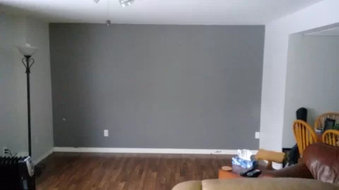

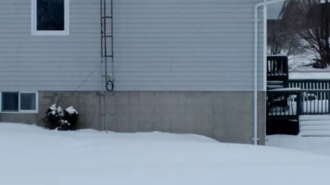

Ok, so the stove will be centered on this wall with the pipe going up a few feet above the stove to get above grade. As you can see I have lots of finishing work to do down there so boxing in a kit is doable. I'll probably route it to the left at floor level because it will exit outside at slightly above ground level. The outside section of chimney will come thru the block roughly half way between the tower and the corner of the wall.
So..you plan to run your OAK along the baseboard toward the opposite wall?
Possibly. I was just going to try and avoid the two pipes visible above the stove but if that's what I have to end up with, so be it. I am lucky in that the small wall to the left is deeper then normal to accommodate some plumbing so I will be able to get the exit point of the OAK a few feet in the air if that's the route I end up going.
