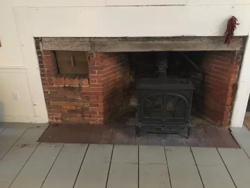

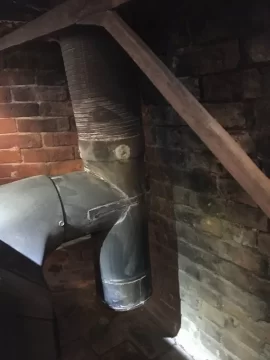

After a million years of waffling around and spending my woodstove budget on other parts of the house, I finally got around to ordering a new stove (WS Absolute Steel-- thread to come). Now my issue is figuring out the details of remodeling my hearth and determining the health of my flue liner.
- I believe the flue liner is ~20 years old (to match the double door F400). It is uninsulated and runs ~24' from the cleanout to the chimney cap. For many of those years, it was cleaned from the top via metal brush and I've recently starting cleaning it from the bottom via a poly Sooteater. From what I can see when I clean it out, the liner appears to be in ok shape to my uneducated self. What kind of life should I be expecting from a liner? If it doesn't show signs of breaking down, is it still prudent to replace the liner for safety reasons based on age? Would installing a new, insulated liner give me a noticeable performance benefit over my existing set-up? I've attached a photo of the Tee to try to capture what looks like is maybe corrosion?
- The existing set up hasn't been up to snuff in regards to hearth floor fire protection and is definitely a project I'm relieved to be tackling. My plan here is to remove the square tiles and another ~20" of wood flooring and re-build with cement board and then brick tiles. Anyone see anything else I should be considering?
The AS will have a left-hand door and be rear vented.
[Hearth.com] Pulled the trigger on a new stove-- time to replace the flexliner? (photos) [Hearth.com] Pulled the trigger on a new stove-- time to replace the flexliner? (photos)
I am no expert with all of this but I will give you my opinion---anyway----lol.. I would get a new insulated liner and I am so glad you are going to fix those rotten bricks as well...Safety First I say...Heck new stove---go all the way for safety or get one of those things that you can look up into the pipe with and see the condition of it...My I almost got killed by carbon dioxide so get a new liner one that you can clean better than getting up on a roof too...Mrs. clancey
View attachment 277849 View attachment 277850
A heavy wall liner like yours should last 30 years unless abused. Cleaning with a steel brush may have taken a few years off the life though. So if it was insulated I would say have it inspected and it will probably be perfectly fine. But it should really be insulated. If it was newer I would say yank it out insulate it and drop it back in. But I am not sure I would reinstall a liner that old.

I just completed the project of replacing an insert. I can't see from your pics if you have a register plate. Make sure you have a register plate and that it is well insulated. I used Rockwool insulation and a lot of aluminum sheet metal. Aluminum is a better choice than steel because it reflects 95% of radiant heat. Also, if galvanized steel gets too hot, the zinc coating turns into a poisonous gas. I don't know how likely that is to happen, but why take the chance? Because the fireplace is in the basement on an outside wall, I put aluminum sheet medal all around the back and floor of the fireplace to keep as much heat as possible in the room. I put the stove up on three bricks to further reduce heat loss to the floor, which in the basement is a heat sink.
Is the chimney liner steel or stainless steel? Regular steel rusts, stainless steel has a longer life. Unless it is heat damaged somehow, I don't know what else would shorten the life of stainless steel. Give it a good visual inspection to look for damage or holes. If it looks good, I can't think of a reason to replace it. Since its inside the chimney, why does it need to be insulated? (I assume the chimney is masonry.) Unless that is required to meet some code requirement or fire safety reasons, I don't see the point of it.
Register plate meaning block-off plate in the damper area, correct?
Yes, there may be a technical meaning, but just make sure something keeps all the heat from going up the chimney.
The install does have a a steel block off plate a few inches above the bottom of the lintel. I'm unsure of what's above it. When I rap on it with my knuckles, I'm still undecided on if it feels like there's insulation sitting on it or not. I would guess not.
It's (STILL!) snowing here in southern Vermont but as soon as the roof dries I'll climb back up there with some tools and take a few more photos of the chimney and liner with the stove removed. The liner is stainless and was painted black in the area below the lintel.
For what it's worth, the chimney is interior and climbs ~9 feet but then runs the remaining 15' through an unconditioned attic. I had the chimney brick above the roof line rebuilt last summer. It's lined with a rectangular terracotta liner and the mason who redid the bricks gave that a thumbs up at that time. I think I'm leaning towards ripping it out and putting in a new, insulated liner, but I wanted to make sure I wasn't needlessly throwing money at a non-issue. I sometimes get a little... enthusiastic with my projects. ;)

The insulated pipe keeps more heat inside it and out of the chimney. So your present pipe does a better job of radiating heat to the chimney masonry, and thus into your house. With a masonry chimney, I don't see any safety issue, so no reason to change it. I'd call it throwing money away on a non-issue and decreasing the thermal efficiency of your chimney. I'd take out the steel register plate, check or replace the insulation, and consider adding aluminum when reinstalling. From the stainless steel I've been working with, it's relatively indestructible. Even drilling it resulted in the metal deforming more than getting cut by the bit until it failed from metal fatigue. I don't see the point of replacing it without a good reason.
There is absolutely a safety issue unless the chimney has the required 2" clearance to combustibles from the outside of the masonry structure. It is required by code for a very good reason and the only way to make a chimney without that clearance compliant and safe is with an insulated liner. And believe me stainless is not indestructible. I pull out a few failed liners a year.

The only way to know if the liner is in good condition is by having a pro inspect with a camera. You just can't see enough any other way
