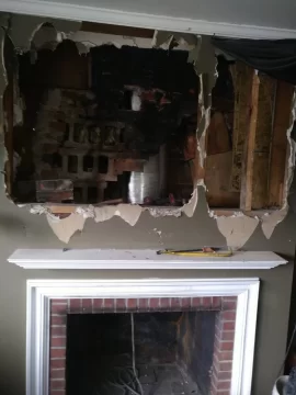

- I thoroughly understand what I'm getting into in regards to moving from a tube stove to a hybrid stove, maintaining a catalyst, lower flue temps for longer, etc (and am excited about it!).
- My brick fireplace column is pretty beefy, but there are certainly combustibles touching the bricks at both the attic floor and the roof line.
- Given the amount of creosote I clean out of my chimney each season, I have felt like my hearth pad and mantel trim clearances were more of a safety hazard than the flex/masonry/brick chimney set up, but I'm a handy DIY homeowner, not a code-aware chimney sweep which is why I was motivated to post my question to begin with. For me, if insulating this particular liner set up was going to give me performance improvements, then I'll likely pull the old liner out and throw in a new one. It's nothing I can't do in a day and this end of the house is going to undergo some extensive remodeling, so with a new stove also in the cards, the new liner is actually pretty trivial in the scope of the whole picture. I've been renting this house and am in the process of buying it from the owners and so these upgrades are on the ASAP timeline now.
- I'm a member of my town's volunteer fire department and for a town of only 1,900 residents, we sure see an awful lot of chimney fires each winter. I've seen some horrific set ups and some very clogged chimneys and am well aware that a new liner and a sweep is a lot cheaper than the damage that a fire and the fire department will do to my house. I like fire safety.

You obviously didn't read the provided code. A chimney cannot be used to support combustible structure without a ul-1777 liner rated for zero clearance to the masonry or if it is part of a masonry wall and that combustible is atleast 12" from the clay liner. Which at that point it is being supported by the masonry wall.
You seem to have lots of opinions but very little knowledge of the issues at hand. Btw this is what I am working on today. It was a structure fire caused by lack of clearance to combustibles. I do this stuff all day every day. I don't know what makes you think you are more qualified than me.
