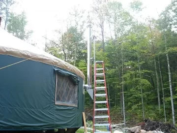

That doesn't sound bad. After the elbows how long is your chimney?
Umm, don't remember the exact height. Here is a pic..
[Hearth.com] Pulled Trigger On Ideal Steel Hybrid
Are these 36" or 48" chimney sections?
Isn't the minimum 15ft? With those elbows in there you have got to be well under the minimum spec.

I believe they are 48", but I don't remember for sure. We put that chimney up like 3 years ago. I am not sure of the height from the flue collar, but it has to be pretty close if not more than 15'.

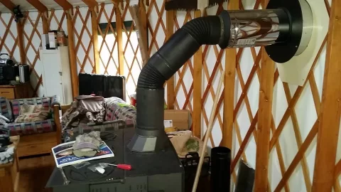

I was guessing 12' outside with about an 21" rise inside. Trouble is the two 90 deg elbows plus the long horizontal effectively reduce the height by about 3-5 ft.. To make it work as best as possible switch to double-wall connector inside, soften the interior 90 with 2-45s and an offset, reduce the horiz length by at least 6". 12" if possible would be better. That should improve performance notably during 30-40F weather.

Cat stoves are picky when it comes to draft, a chimney at or near the minimum height needs to be as close to a straight shot up as possible to perform well.
Just an update. I changed the pipe a bit to use two 45's instead of a 90 above the stove:
I hope this will help with draft issues.
