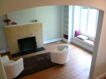

I have included a general photo of living room with fireplace so that you can get an idea of existing fireplace. Dealer has said that both BK Princess Insert and PE NEO 2.5 will fit.

It looks like you'll need an extender in front of the hearth. NFPA says 16" minimum. You can use a temporary extender that you can put away when done burning for the season.

As for the hearth, the dealer says that I am in regs by a quarter of an inch on his projections. So I may very well go with a temporary extender rather than redoing the floors.
