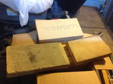

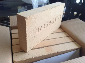

I plan to purchase a used Hampton H300 this week and I would like to know if their are any specific items I should have in mind to ensure the fire box is safe to use.
The stove was purchased new in 2006 and appears to be in good condition, however there are some seamingly minor issues I plan to repair. My main concern is damaged and falling apart firebrick. Replacing it shouldn’t be hard however there is a spot that you can see thru to the metal. Once the owner noticed this they used additional firebick placed in front of the original firebrick to continue use.
Is there reason to be concerned of the integrity of the fire box from fires that may have been burned prior to the additional firebrick? I plan to replace all the firebrick. I appreciate any advice you can offer.
