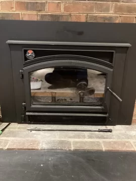

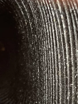

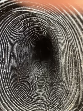

Good morning! Wood burning rookie here. I have a new, dealer installed, fixed rate EPA wood burning insert. Im trying to determine what temp range to try to run the stove at, and where that temp should be taken. I’ve been using an IR to read collar and box temps. At about 450 in the box (through the glass), I read about 250 on the collar. I’ve been running the stove here, by limiting the amount of wood since I can’t regulate the air with this thing. The dealer won’t commit to a temperature (I don’t think they know) and they are evasive. Quadrafire told me they won’t commit to a temperature, and to talk to the dealer. I’ve got a slight amount of creosote at the top of my chimney after running about ten loads of wood through. My wood is around 20 percent or under. Given the pics, I’m inclined to say I’m too cold, but what do you guys think?

Yes, it looks like the stove is being run too cool. Temp measured though the glass is meaningless. The top of the insert door would be better. You can take it up to around 600-650º there. While reading temps, compare the left or right recessed area just above the door. Compare. If that area is close to the door temp reading, will a 2" round thermometer fit there?

Right where thermometer is in this picture? Highest I’ve gotten is about 240 in that spot. At that temperature, the flame is extremely high, even with a small amount of wood.
Yes. Looking at the flue liner it doesn't appear that the stove is getting too hot. Try another fire with 3-4 larger splits and see how it does.
