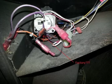

So I finally got around to checking out the stove. I do think the fan is on its way out. I think the majority of the noise is coming from the bearings. But aside from that the issue of the convection fan not changing speed is still an issue. I tried to insert the pic but I can only upload it (maybe I am missing something) I pointed out what I found which looks like a jumper or something. It was wrapped in elec. tape so I figure it probably isn't factory. However it looks like it goes to Snap disc #2.
Also on these fans you can't just replace the bearings can you?
Thoughts?

As best I can tell in your pic, the near snap disk is #1 (and looks OK) for the convection fan; the other one is #2 (orange wire and possibly a reset button on it) for the auger. I think you are pointing to the capacitor for the auger motor.
ok, I just wasn't sure. Like I said it was wrapped pretty messy with elec. tape, not like I would expect if it was factory. Then again I can't imagine the factory using elec. tape that way!
But I guess for now I just let it be. At least it's heating the house.
