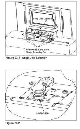

It could be a defective snap disc thermostat or perhaps it isn't making good contact with the stove body? Look at page 24 for replacement instructions. I would try a little thin shimming of the snap switch first. If that doesn't work, replace it.

Absolutely- any part of the stove glowing and the blower not on is an indication of snap disk issue not making proper contact with stove body or is defective. I'd run in manual until you get is serviced/replaced.
