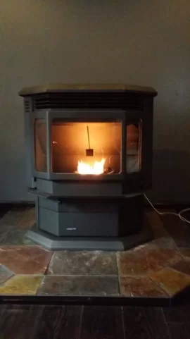

okay, so attached are 2 pictures of my classic bay (had to take one with the lights off to get that I'm burning fire in my home feel). I'll save my Q&A for then end, so settle down and enjoy the ride.

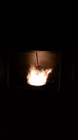

1- attached pic (on high setting) doesn't look to be 4-6" flame (or is it?). Is that flame size supposed to be constant or will id reduce to a small "flicker" contained within the pot till it gets more fuel?

Looking nice.

Did you see smoke come out of the stove? New stoves do smell when they are lit for the first time..
some came out of the blower when I first started it up, but that could be from my previous attempts to start the stove (pre thermostat install) when nothing happened. after I aired out the house no more smoke came through. Was curious if this would happen every time I start the stove.
No smoke should come out into room.
Well, if it came out before the stove got hot, it probably is pellet smoke on start up. It would be a leak that gets sucked out the heat exchange system, probably from the vent pipes. Once the stove gets hot you don't get as much smoke anymore and it drafts better, so you get less smoke leaking out, to the point where you don't notice it anymore.
Now if the smoke came after the stove got really hot, and it smelled chemically, then that is the stove paint curing. They should have warned you about this. But it only happens on the first fire.
The fire box will fill with smoke when lighting..then when it lights get blown out exhaust.
At night, with all the lights off, take a flashlight and start up the stove. Shine the flashlight on the back of the stove, around the vent pipe, the seams are a good place to look. You will see the wisps of smoke that are leaking out. It has to be on start up though, when there is a lot of smoke.
