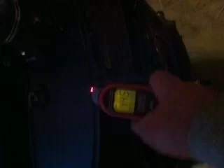

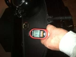

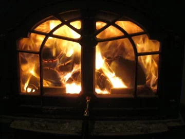

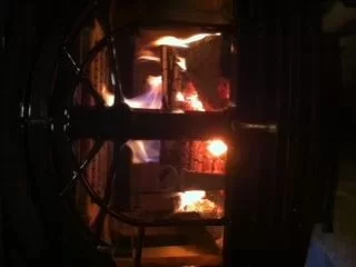

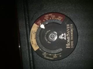

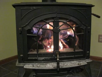

Ok, here with pics.
First the fire box burning with 3 pine splits

Next is crappy coil thermo during the burn
[Hearth.com] Quadra-Fire Isle Royale Owners Please (or other large cast iron stoves)[Hearth.com] Quadra-Fire Isle Royale Owners Please (or other large cast iron stoves)
Next is IR reading next to coil thermo[Hearth.com] Quadra-Fire Isle Royale Owners Please (or other large cast iron stoves)
And last we have the hottest spot on the cook top (in the front)

In the photo you posted it looks exactly like my isle royale and the temps appear the same as I experience. Are your secondary tubes red in those photos? They look normal
The photos of the stove look great--well controlled fire and minor secondary flames. Tubes look normal to me also.
I take it the tubes were glowing in a different situation: when the primary air was wide open and stovetop was 550. That situation isn't going to last very long
because you're going to be turning your primary air down in stages, and the roaring fire is going to be a lazy, controlled fire like the one in your photos.
In any event, I've taken my stovetop to 550 and even 600 before starting to turning the air down. I don't recommend 600 because the secondaries can
turn to hellfire and a stovetop of 700 before you know it. When that happens, I'm paying close attention to my stovetop and not my burn tubes. Even when
flames are shooting out of nearly all of the airholes of the tubes, I can't say I've noticed that the tubes themselves glow red. At 550, I definitely don't think you had an overfire.

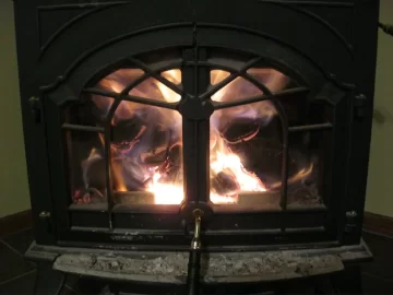

Reloaded on a coalbed of 200, and this is at stovetop 550 with the primary air open (about 15 minutes later).
Next one is at 625 and the air closed 80%.
Last one is 600 and the air closed 90%
